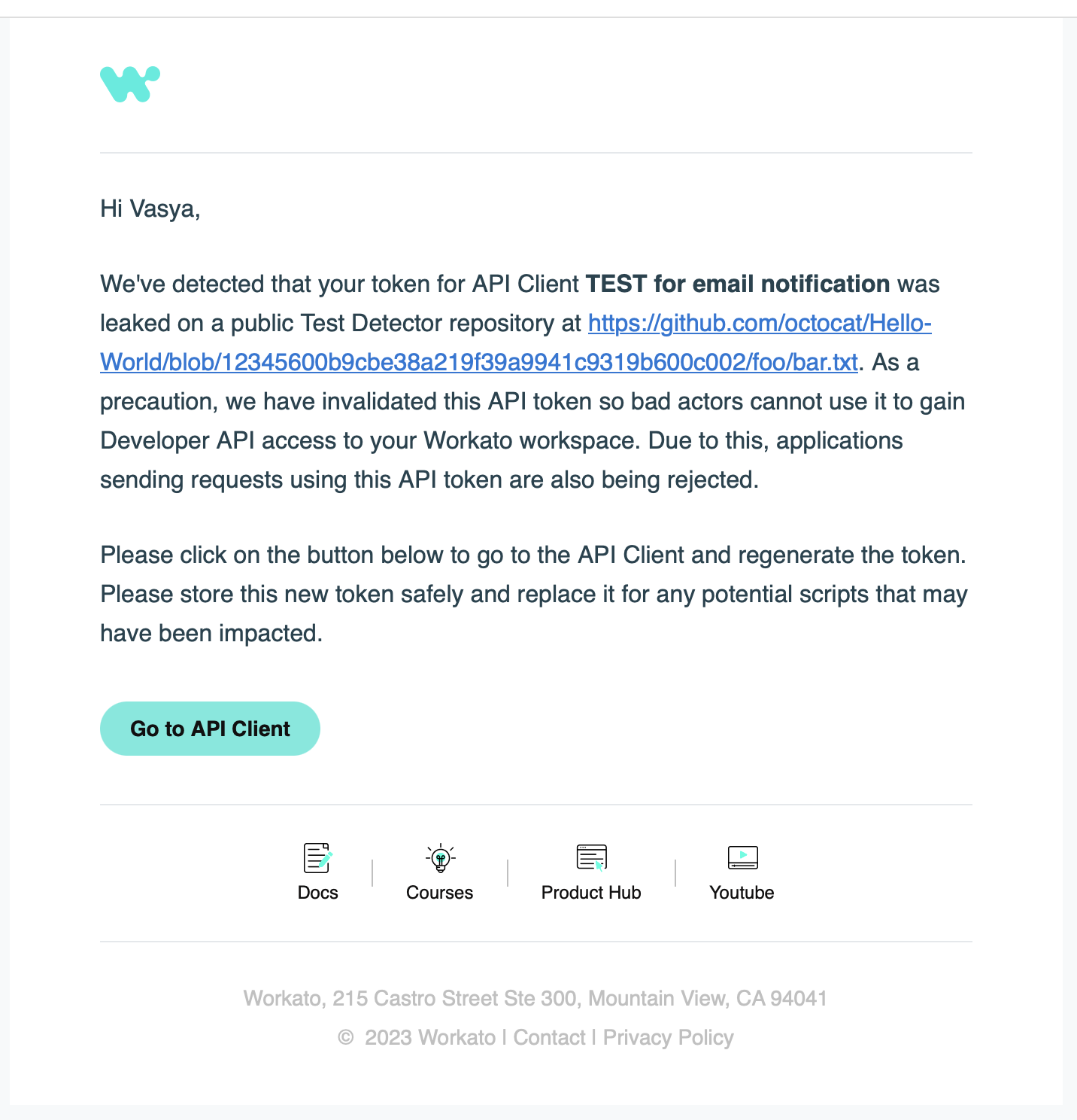

When these tokens are found, Workato will perform the following steps:
  1. Revoke your Developer API token to ensure no bad actors can have unauthorized access to your Workato workspace
  2. Send an email to the workspace admins about the leaked token, including information about where it was found and how to recover from the leaked token
Leaked token email
TIP
Remember to add your Workspace admins to your email notification lists to ensure that relevant individuals are informed if tokens are leaked. This can be done by going to your Workspace settings when logged in as the workspace admin.

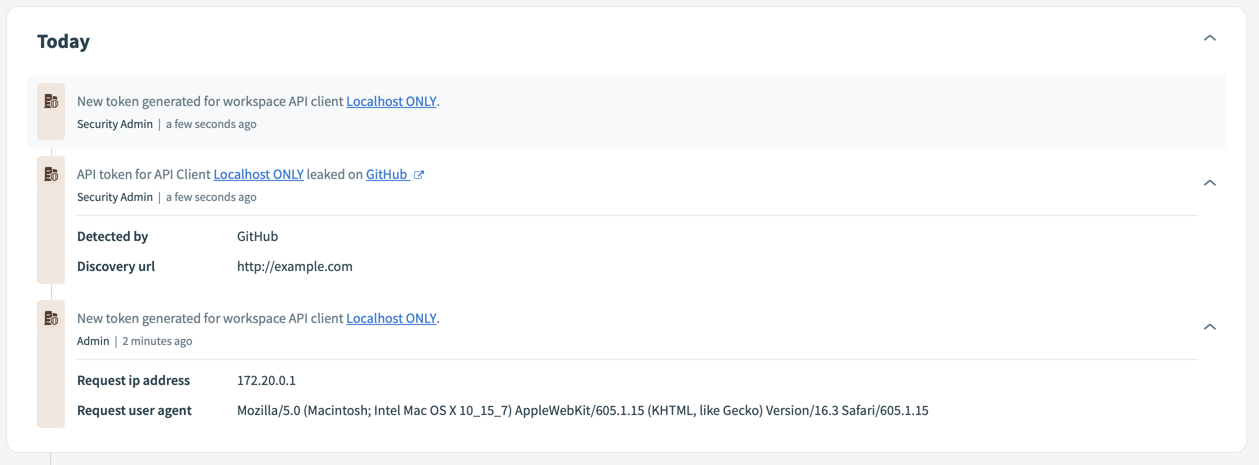

  1. Mark the API Client as leaked on the Workato UI
  2. Add an audit log event indicating that the API token was leaked
Leaked token audit event
