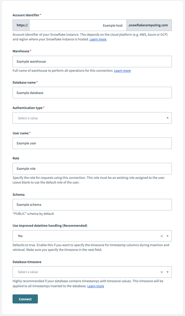

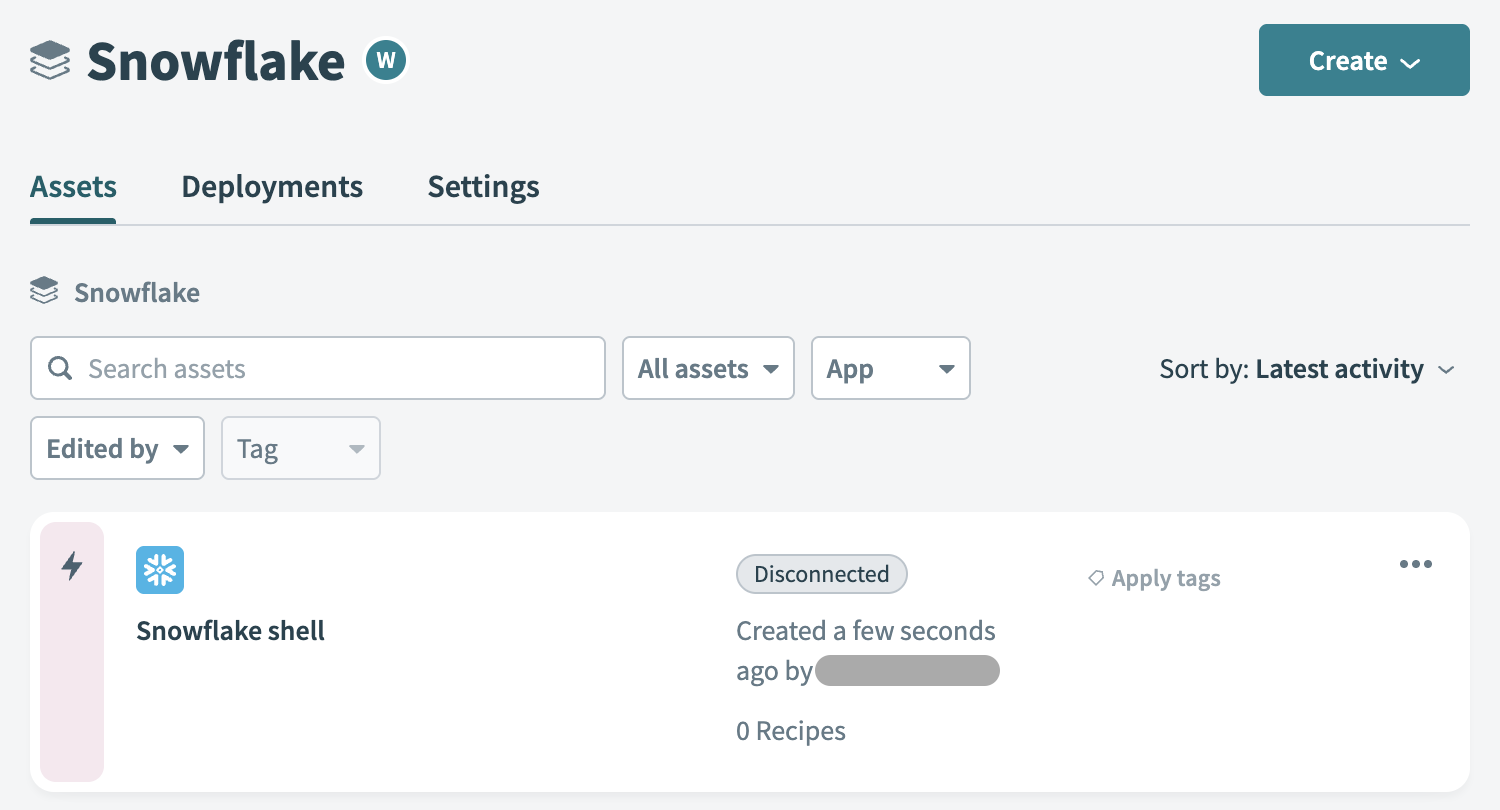

Create and authenticate a shell connection
Complete the following steps to create and authenticate a shell connection:
Create a shell connection using the Create a connection endpoint. For example:
$ curl -X POST https://www.workato.com/api/connections \ > -H 'Authorization: Bearer <api_token>' \ > -H 'Content-Type: application/json' \ > -d '{ > "name": "Snowflake shell", > "provider": "snowflake", > "folder_id": 1234567, > "shell_connection": true, > "input": { > "authentication_type": ["OAuth 2.0", "oauth"], > "warehouse": "Example warehouse", > "host": "Example host", > "database": "Example database", > "role": "Example role", > "user": "Example user", > "schema_name": "Example schema", > "db_timezone": ["American Samoa", "American Samoa"] > } > }'
Sign in to Workato.
Open the project where you stored the shell connection.
Complete the remaining fields. Refer to the Connectors section of Workato’s documentation for connector-specific authentication steps.

Snowflake
Provider value:
1 "provider": "snowflake"
View connection parameters JSON
1 { 2 "oauth": true, 3 "personalization": true, 4 "input": [ 5 { 6 "label": "Account identifier", 7 "optional": false, 8 "hint": "Account identifier of your Snowflake instance. This depends on the cloud platform, such as AWS, Azure, or GCP, and region where your Snowflake instance is hosted. Refer to the Snowflake connector documentation for more information: https://docs.workato.com/connectors/snowflake.html#how-to-connect-to-snowflake-on-workato", 9 "type": "string", 10 "name": "host" 11 }, 12 { 13 "label": "Warehouse", 14 "hint": "Full name of warehouse to perform all operations for this connection. Refer to the Snowflake connector documentation for more information: https://docs.workato.com/connectors/snowflake.html#warehouse-considerations", 15 "type": "string", 16 "name": "warehouse" 17 }, 18 { 19 "label": "Database name", 20 "type": "string", 21 "name": "database" 22 }, 23 { 24 "label": "Authentication type", 25 "default": "key_pair", 26 "type": "string", 27 "name": "authentication_type", 28 "pick_list": [ 29 [ 30 "OAuth 2.0", 31 "oauth" 32 ], 33 [ 34 "Key-pair authentication", 35 "key_pair" 36 ], 37 [ 38 "Username/Password (Deprecated)", 39 "basic" 40 ] 41 ] 42 }, 43 { 44 "label": "User name", 45 "type": "string", 46 "name": "user" 47 }, 48 { 49 "label": "Password", 50 "hint": "Snowflake plans to deprecate single-factor password authentication for users by November 2025. Refer to the Snowflake connector documentation for more information: https://docs.workato.com/connectors/snowflake.html#configure-username-password-authentication", 51 "optional": true, 52 "type": "string", 53 "name": "password" 54 }, 55 { 56 "label": "Private key", 57 "optional": true, 58 "hint": "Paste your private key in PKCS 8 format. Use '\n' characters sequence to join all pem lines into one json string. The Private key field is ignored by the connection when the Password field is provided. Refer to the Snowflake Key Pair Authentication documentation for more information: https://docs.snowflake.com/en/user-guide/key-pair-auth", 59 "type": "string", 60 "name": "private_key" 61 }, 62 { 63 "label": "Private key passphrase", 64 "optional": true, 65 "hint": "You must enter the passphrase if the private key is encrypted.", 66 "type": "string", 67 "name": "private_key_passphrase" 68 }, 69 { 70 "label": "Client ID", 71 "hint": "Refer to the Snowflake connector documentation to obtain a Client ID and Client secret: https://docs.workato.com/connectors/snowflake.html#configuring-oauth-2-0", 72 "type": "string", 73 "name": "client_id" 74 }, 75 { 76 "label": "Client secret", 77 "hint": "Refer to the Snowflake connector documentation to obtain a Client ID and Client secret: https://docs.workato.com/connectors/snowflake.html#configuring-oauth-2-0", 78 "type": "string", 79 "name": "client_secret" 80 }, 81 { 82 "label": "Role", 83 "optional": true, 84 "hint": "Specify the role for requests using this connection. This role must be an existing role assigned to the user. Leave blank to use the default role of the user.", 85 "type": "string", 86 "name": "role" 87 }, 88 { 89 "label": "Schema", 90 "optional": true, 91 "hint": "PUBLIC schema by default", 92 "type": "string", 93 "name": "schema_name" 94 }, 95 { 96 "label": "Use improved datetime handling (Recommended)", 97 "optional": true, 98 "hint": "Defaults to true. Enable this if you plan to specify the timezone for timestamp columns during insertion and retrieval. Make sure you specify the timezone in the next field.", 99 "type": "boolean", 100 "name": "improved_datetime_handling" 101 }, 102 { 103 "label": "Database timezone", 104 "optional": true, 105 "hint": "Highly recommended if your database contains timestamps with timezone values. This timezone will be applied to all timestamps inserted to the database. Refer to the Snowflake connector documentation for more information: https://docs.workato.com/connectors/snowflake.html#database-timezone", 106 "type": "string", 107 "name": "db_timezone", 108 "pick_list": [ 109 [ 110 "American Samoa", 111 "American Samoa" 112 ], 113 [ 114 "International Date Line West", 115 "International Date Line West" 116 ], 117 [ 118 "Midway Island", 119 "Midway Island" 120 ], 121 [ 122 "Hawaii", 123 "Hawaii" 124 ], 125 [ 126 "Alaska", 127 "Alaska" 128 ], 129 [ 130 "Pacific Time (US & Canada)", 131 "Pacific Time (US & Canada)" 132 ], 133 [ 134 "Tijuana", 135 "Tijuana" 136 ], 137 [ 138 "Arizona", 139 "Arizona" 140 ], 141 [ 142 "Chihuahua", 143 "Chihuahua" 144 ], 145 [ 146 "Mazatlan", 147 "Mazatlan" 148 ], 149 [ 150 "Mountain Time (US & Canada)", 151 "Mountain Time (US & Canada)" 152 ], 153 [ 154 "Central America", 155 "Central America" 156 ], 157 [ 158 "Central Time (US & Canada)", 159 "Central Time (US & Canada)" 160 ], 161 [ 162 "Guadalajara", 163 "Guadalajara" 164 ], 165 [ 166 "Mexico City", 167 "Mexico City" 168 ], 169 [ 170 "Monterrey", 171 "Monterrey" 172 ], 173 [ 174 "Saskatchewan", 175 "Saskatchewan" 176 ], 177 [ 178 "Bogota", 179 "Bogota" 180 ], 181 [ 182 "Eastern Time (US & Canada)", 183 "Eastern Time (US & Canada)" 184 ], 185 [ 186 "Indiana (East)", 187 "Indiana (East)" 188 ], 189 [ 190 "Lima", 191 "Lima" 192 ], 193 [ 194 "Quito", 195 "Quito" 196 ], 197 [ 198 "Atlantic Time (Canada)", 199 "Atlantic Time (Canada)" 200 ], 201 [ 202 "Caracas", 203 "Caracas" 204 ], 205 [ 206 "Georgetown", 207 "Georgetown" 208 ], 209 [ 210 "La Paz", 211 "La Paz" 212 ], 213 [ 214 "Santiago", 215 "Santiago" 216 ], 217 [ 218 "Newfoundland", 219 "Newfoundland" 220 ], 221 [ 222 "Brasilia", 223 "Brasilia" 224 ], 225 [ 226 "Buenos Aires", 227 "Buenos Aires" 228 ], 229 [ 230 "Greenland", 231 "Greenland" 232 ], 233 [ 234 "Montevideo", 235 "Montevideo" 236 ], 237 [ 238 "Mid-Atlantic", 239 "Mid-Atlantic" 240 ], 241 [ 242 "Azores", 243 "Azores" 244 ], 245 [ 246 "Cape Verde Is.", 247 "Cape Verde Is." 248 ], 249 [ 250 "Casablanca", 251 "Casablanca" 252 ], 253 [ 254 "Dublin", 255 "Dublin" 256 ], 257 [ 258 "Edinburgh", 259 "Edinburgh" 260 ], 261 [ 262 "Lisbon", 263 "Lisbon" 264 ], 265 [ 266 "London", 267 "London" 268 ], 269 [ 270 "Monrovia", 271 "Monrovia" 272 ], 273 [ 274 "UTC", 275 "UTC" 276 ], 277 [ 278 "Amsterdam", 279 "Amsterdam" 280 ], 281 [ 282 "Belgrade", 283 "Belgrade" 284 ], 285 [ 286 "Berlin", 287 "Berlin" 288 ], 289 [ 290 "Bern", 291 "Bern" 292 ], 293 [ 294 "Bratislava", 295 "Bratislava" 296 ], 297 [ 298 "Brussels", 299 "Brussels" 300 ], 301 [ 302 "Budapest", 303 "Budapest" 304 ], 305 [ 306 "Copenhagen", 307 "Copenhagen" 308 ], 309 [ 310 "Ljubljana", 311 "Ljubljana" 312 ], 313 [ 314 "Madrid", 315 "Madrid" 316 ], 317 [ 318 "Paris", 319 "Paris" 320 ], 321 [ 322 "Prague", 323 "Prague" 324 ], 325 [ 326 "Rome", 327 "Rome" 328 ], 329 [ 330 "Sarajevo", 331 "Sarajevo" 332 ], 333 [ 334 "Skopje", 335 "Skopje" 336 ], 337 [ 338 "Stockholm", 339 "Stockholm" 340 ], 341 [ 342 "Vienna", 343 "Vienna" 344 ], 345 [ 346 "Warsaw", 347 "Warsaw" 348 ], 349 [ 350 "West Central Africa", 351 "West Central Africa" 352 ], 353 [ 354 "Zagreb", 355 "Zagreb" 356 ], 357 [ 358 "Athens", 359 "Athens" 360 ], 361 [ 362 "Bucharest", 363 "Bucharest" 364 ], 365 [ 366 "Cairo", 367 "Cairo" 368 ], 369 [ 370 "Harare", 371 "Harare" 372 ], 373 [ 374 "Helsinki", 375 "Helsinki" 376 ], 377 [ 378 "Jerusalem", 379 "Jerusalem" 380 ], 381 [ 382 "Kaliningrad", 383 "Kaliningrad" 384 ], 385 [ 386 "Kyiv", 387 "Kyiv" 388 ], 389 [ 390 "Pretoria", 391 "Pretoria" 392 ], 393 [ 394 "Riga", 395 "Riga" 396 ], 397 [ 398 "Sofia", 399 "Sofia" 400 ], 401 [ 402 "Tallinn", 403 "Tallinn" 404 ], 405 [ 406 "Vilnius", 407 "Vilnius" 408 ], 409 [ 410 "Baghdad", 411 "Baghdad" 412 ], 413 [ 414 "Istanbul", 415 "Istanbul" 416 ], 417 [ 418 "Kuwait", 419 "Kuwait" 420 ], 421 [ 422 "Minsk", 423 "Minsk" 424 ], 425 [ 426 "Moscow", 427 "Moscow" 428 ], 429 [ 430 "Nairobi", 431 "Nairobi" 432 ], 433 [ 434 "Riyadh", 435 "Riyadh" 436 ], 437 [ 438 "St. Petersburg", 439 "St. Petersburg" 440 ], 441 [ 442 "Tehran", 443 "Tehran" 444 ], 445 [ 446 "Abu Dhabi", 447 "Abu Dhabi" 448 ], 449 [ 450 "Baku", 451 "Baku" 452 ], 453 [ 454 "Muscat", 455 "Muscat" 456 ], 457 [ 458 "Samara", 459 "Samara" 460 ], 461 [ 462 "Tbilisi", 463 "Tbilisi" 464 ], 465 [ 466 "Volgograd", 467 "Volgograd" 468 ], 469 [ 470 "Yerevan", 471 "Yerevan" 472 ], 473 [ 474 "Kabul", 475 "Kabul" 476 ], 477 [ 478 "Ekaterinburg", 479 "Ekaterinburg" 480 ], 481 [ 482 "Islamabad", 483 "Islamabad" 484 ], 485 [ 486 "Karachi", 487 "Karachi" 488 ], 489 [ 490 "Tashkent", 491 "Tashkent" 492 ], 493 [ 494 "Chennai", 495 "Chennai" 496 ], 497 [ 498 "Kolkata", 499 "Kolkata" 500 ], 501 [ 502 "Mumbai", 503 "Mumbai" 504 ], 505 [ 506 "New Delhi", 507 "New Delhi" 508 ], 509 [ 510 "Sri Jayawardenepura", 511 "Sri Jayawardenepura" 512 ], 513 [ 514 "Kathmandu", 515 "Kathmandu" 516 ], 517 [ 518 "Almaty", 519 "Almaty" 520 ], 521 [ 522 "Astana", 523 "Astana" 524 ], 525 [ 526 "Dhaka", 527 "Dhaka" 528 ], 529 [ 530 "Urumqi", 531 "Urumqi" 532 ], 533 [ 534 "Rangoon", 535 "Rangoon" 536 ], 537 [ 538 "Bangkok", 539 "Bangkok" 540 ], 541 [ 542 "Hanoi", 543 "Hanoi" 544 ], 545 [ 546 "Jakarta", 547 "Jakarta" 548 ], 549 [ 550 "Krasnoyarsk", 551 "Krasnoyarsk" 552 ], 553 [ 554 "Novosibirsk", 555 "Novosibirsk" 556 ], 557 [ 558 "Beijing", 559 "Beijing" 560 ], 561 [ 562 "Chongqing", 563 "Chongqing" 564 ], 565 [ 566 "Hong Kong", 567 "Hong Kong" 568 ], 569 [ 570 "Irkutsk", 571 "Irkutsk" 572 ], 573 [ 574 "Kuala Lumpur", 575 "Kuala Lumpur" 576 ], 577 [ 578 "Perth", 579 "Perth" 580 ], 581 [ 582 "Singapore", 583 "Singapore" 584 ], 585 [ 586 "Taipei", 587 "Taipei" 588 ], 589 [ 590 "Ulaanbaatar", 591 "Ulaanbaatar" 592 ], 593 [ 594 "Osaka", 595 "Osaka" 596 ], 597 [ 598 "Sapporo", 599 "Sapporo" 600 ], 601 [ 602 "Seoul", 603 "Seoul" 604 ], 605 [ 606 "Tokyo", 607 "Tokyo" 608 ], 609 [ 610 "Yakutsk", 611 "Yakutsk" 612 ], 613 [ 614 "Adelaide", 615 "Adelaide" 616 ], 617 [ 618 "Darwin", 619 "Darwin" 620 ], 621 [ 622 "Brisbane", 623 "Brisbane" 624 ], 625 [ 626 "Canberra", 627 "Canberra" 628 ], 629 [ 630 "Guam", 631 "Guam" 632 ], 633 [ 634 "Hobart", 635 "Hobart" 636 ], 637 [ 638 "Melbourne", 639 "Melbourne" 640 ], 641 [ 642 "Port Moresby", 643 "Port Moresby" 644 ], 645 [ 646 "Sydney", 647 "Sydney" 648 ], 649 [ 650 "Vladivostok", 651 "Vladivostok" 652 ], 653 [ 654 "Magadan", 655 "Magadan" 656 ], 657 [ 658 "New Caledonia", 659 "New Caledonia" 660 ], 661 [ 662 "Solomon Is.", 663 "Solomon Is." 664 ], 665 [ 666 "Srednekolymsk", 667 "Srednekolymsk" 668 ], 669 [ 670 "Auckland", 671 "Auckland" 672 ], 673 [ 674 "Fiji", 675 "Fiji" 676 ], 677 [ 678 "Kamchatka", 679 "Kamchatka" 680 ], 681 [ 682 "Marshall Is.", 683 "Marshall Is." 684 ], 685 [ 686 "Wellington", 687 "Wellington" 688 ], 689 [ 690 "Chatham Is.", 691 "Chatham Is." 692 ], 693 [ 694 "Nuku'alofa", 695 "Nuku'alofa" 696 ], 697 [ 698 "Samoa", 699 "Samoa" 700 ], 701 [ 702 "Tokelau Is.", 703 "Tokelau Is." 704 ] 705 ] 706 } 707 ] 708 }
Snowflake (Secondary)
Provider value:
1 "provider": "snowflake_secondary"
